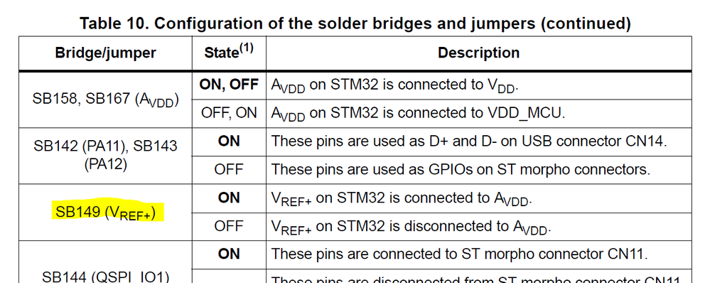

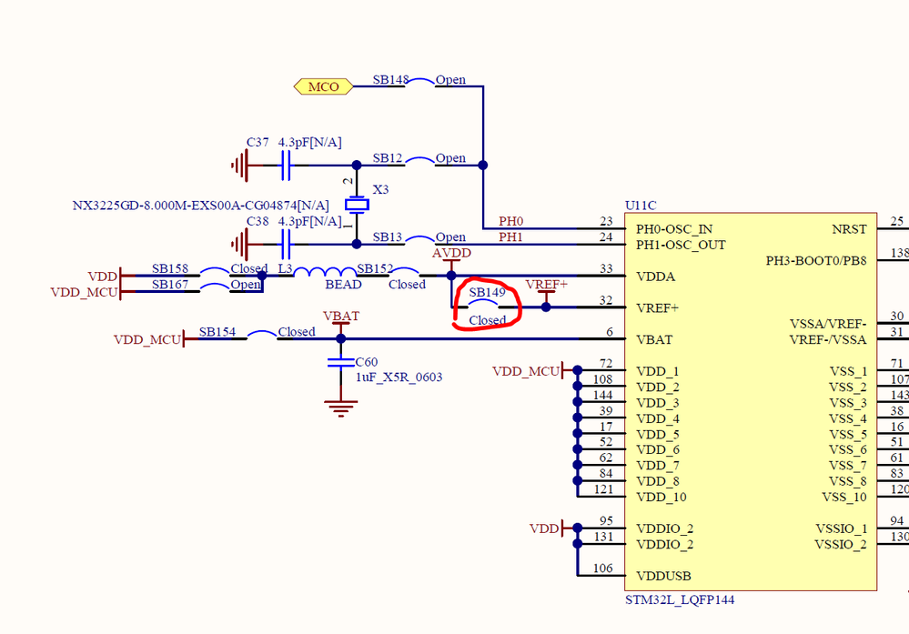

You'll need to disconnect VREF+ from AVDD by removing SB149.
2021-08-10 5:04 AM
How is the VREF+ pin connected externally?
Get the schematics to your board and check the related solder bridges.

That was it!
I also had to bridge (was OFF, now ON) SB119 to access VREF+ via Pin 6 of CN7 and Pin 7 of CN12.
