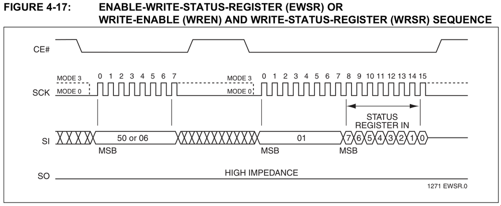

}The problem comes when I try to make this
CE#(NSS) must be driven low before the EWSR (enable write status register) instruction is entered and must be driven high before the EWSR instruction is executed.
CE#(NSS) must be driven low before the command sequence of the WRSR (write status register) instruction is entered and driven high before the WRSR instruction is executed.

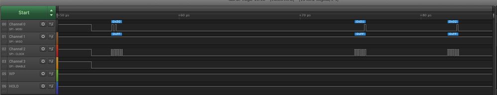

}But looking at the digital levels with a logic analizer this is what the result is:
As you can see, SPI-ENABLE(NSS) is driven low before the start of the first byte (0x50) and then stays that way for the rest of the communication, making the EWSR command invalid.

2019-10-03 11:57 AM
So, I kinda find something to keep going..
The STM32CubeMx intialize the "hspi1.Init.NSS" as "SPI_NSS_HARD_OUTPUT" wich makes the NSS pin be driven by the firmware in it's self. And this made the HAL_GPIO_WritePin command not work.
So I ended up changing a few configurations:
First I change the configuration of the pin itself to be GPIO_MODE_OUTPUT_PP instead of GPIO_MODE_AF_PP.
__HAL_RCC_SPI1_CLK_ENABLE();
__HAL_RCC_GPIOA_CLK_ENABLE();
/**SPI1 GPIO Configuration
PA5 ------> SPI1_SCK
PA6 ------> SPI1_MISO
PA4 ------> SPI1_NSS
PA7 ------> SPI1_MOSI
GPIO_InitStruct.Pin = GPIO_PIN_5|GPIO_PIN_6|GPIO_PIN_7;
GPIO_InitStruct.Speed = GPIO_SPEED_FREQ_VERY_HIGH;
GPIO_InitStruct.Alternate = GPIO_AF0_SPI1;
// PA4 control
GPIO_InitStruct.Pin = GPIO_PIN_4;
HAL_GPIO_Init(GPIOA, &GPIO_InitStruct);Then changed "hspi1.Init.NSS" from "SPI_NSS_HARD_OUTPUT" to:
hspi1.Init.NSS = SPI_NSS_SOFT;This made the signals change whenever the HAL_GPIO_WritePin was called. It also made the logic analyzer not read the SPI signals properly, but thats just bad for the logic analyzer.
