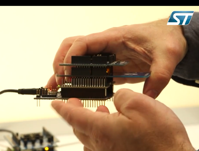

in the video of "Prototype and develop more quickly with STM32 ODE", in minute 1:28 he present the concept of creating an application by stacking different component to demonstart customer project, then he mentioned the most important part that all these components can be moved to a samll form factor board in minute 1:47, where is small board enable customer to do form factor and field test.

The links here (and both links in your duplicate post) don't work - they just go to the ST "Video Center" home page.
Googling "Prototype and develop more quickly with STM32 ODE" finds a few - this seems to match the stills you posted:
