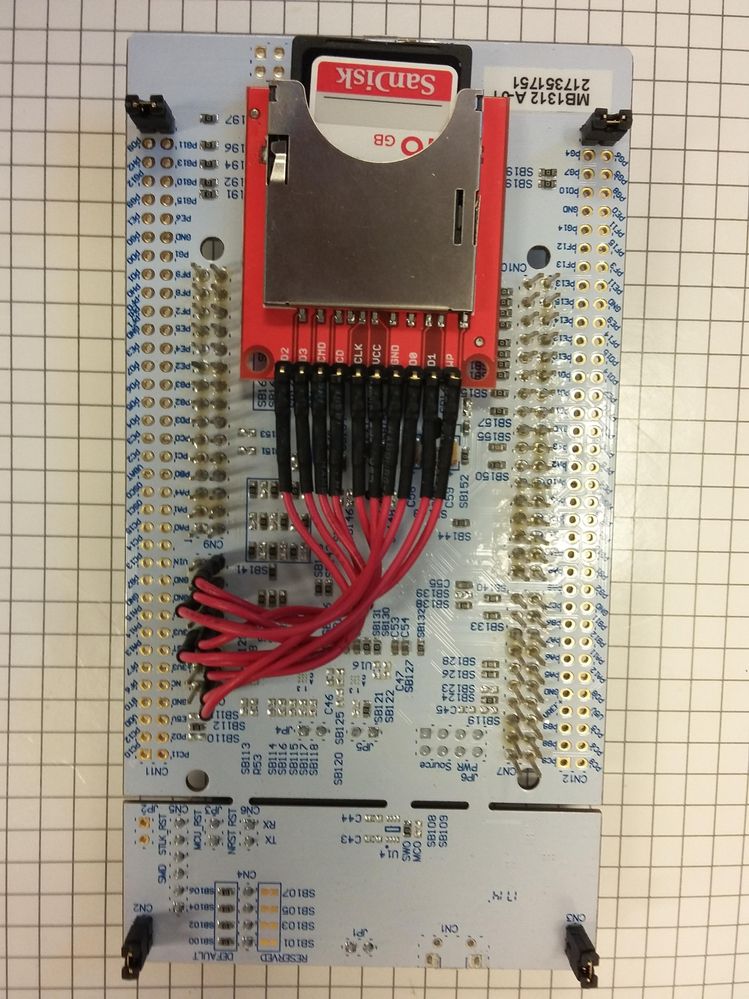

I’m new to this forum and to stm32 board. I’m trying to connect an SD Card to my board NUCLEO-F429ZI but I’m having some problems with it. I use STM32CUBEMX to create the project using the standard peripherals settings. I put SDIO in SD 4 bit interfacing mode. I do not change anything in clock configuration. I connect the SD Card directly to SDIO PIN without any resistors as in picturehttp://www.openstm32.org/dl422?display
Board PIN SD Pin PD2 2 (CMD) PC8 7 (Dat0) PC9 8 (Dat1) PC10 9 (Dat2) PC11 1 (Dat3) PC12 5 (CLK)3.3V VCC

People seem to have a lot of issues with CubeMX in this regard. I just port the examples in the HAL trees.
You should instrument the DISKIO code and look for errors reported there.
Check if you have dependencies on a Card Detect pin.
Here using the two GPIO below the SDMMC signals for the CD, and WP pins
