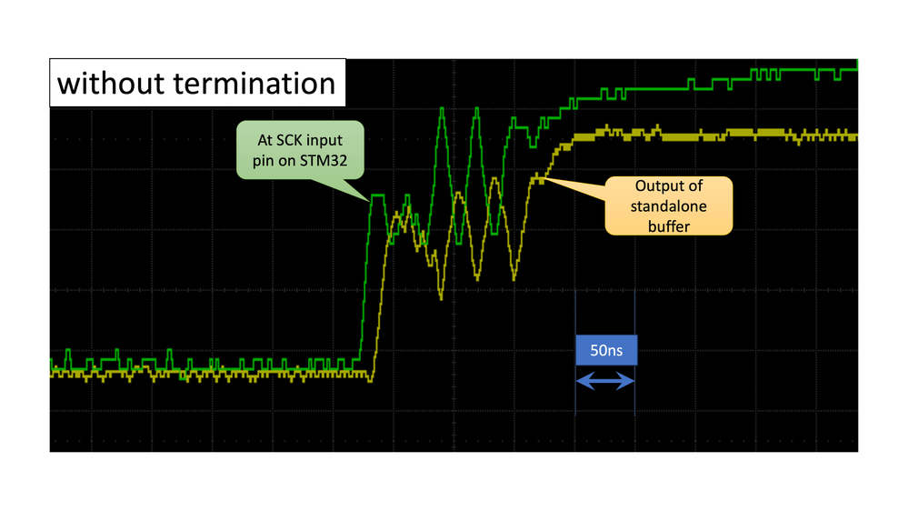

The previous errors looked like bit shifts, and that's definitively caused by the spike in the edge, usually due to reflections. You should've experimented with OSPEEDR settings before adding the serial resistors.

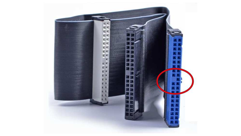

Ground/return should be every other line in the ribbon cable, and every signal should have its own return. Remeber the 80-wire "high speed" PATA cable?

Couldn't use the 80-wire "high speed" 40-pin cable unfortunately, because I found it has a missing connection:
I guess that's how they key it in. too bad :(

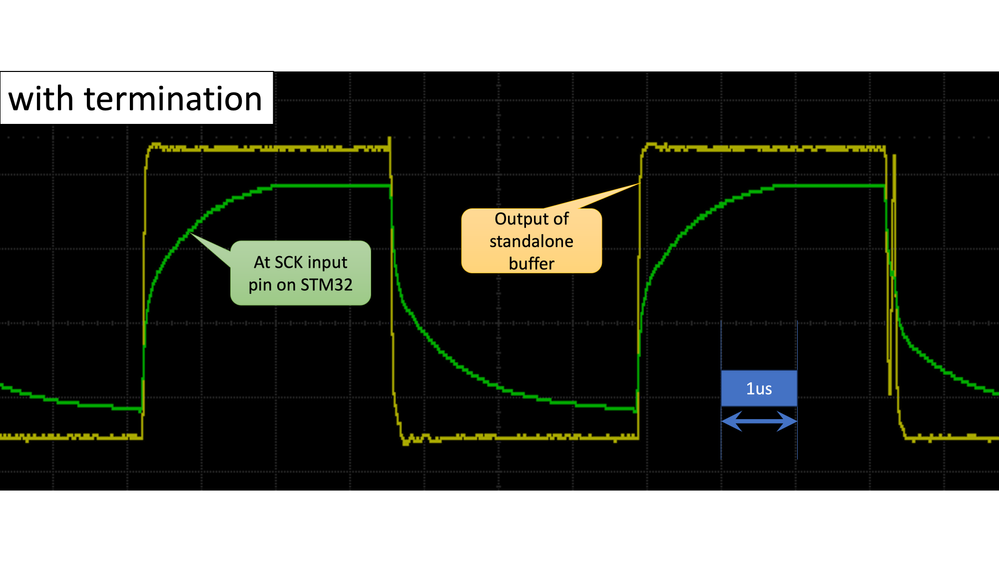

Noise on SCK signal means data is corrupted in both directions, as single posedge clock transitions are counted as multiple...
termination smoothes out the curves, but limits max speed:
the s
the standalone buffer here is really a level shifter with all VDD connected to 3.3V and and all grounds shorted. Just used as a proxy for what the SPI SCK input on stm32 might be getting after the first stage of IO.
