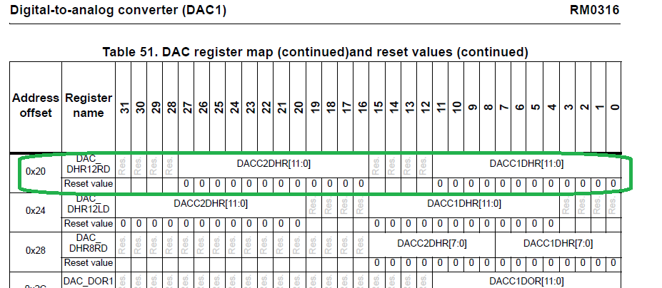

The two-channels used by the original example write a 32-bit value to a 32-bit register that describes two 16-bit samples written to the left/right (1/2) channels simultaneously. In much the way stereo sample would be found in a .WAV, and how the hardware pairs them together in this common register. The architecture is described in the reference manual.This enables a single DMA operation, on a single DMA channel, to write both channels synchronously. Other methods using two DMA channels could be used, but this wastes both bandwidth and resources.The signal level will depend on what load you are driving the signal into, and what output buffering you have chosen. I would expect 4095 to be close to +VREF(VDDA) on a pin that is only connected to a scope input.The max sample rate on the F2/F4 is around 1MSps. 64 points to get 10 KHz (640 KSps) would be doable there.2016-06-27 10:35 AM
#define DAC_DHR12RD_ADDRESS (DAC_BASE + 0x20) // Right Align 12-bit Dual
Not +0x28, which is two 8-bit channels in the low order word.2016-06-27 11:28 AM

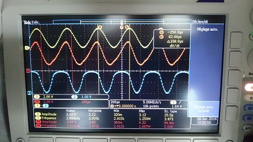

I don't have any F334 boards, this works on a STM32F3-DISCO, providing 3 KHz 3 Vpp Sine waves on PA4 and PA5

I'm building for hardware I have and can test, ie F303 w/RM0316
For the F334 you'll need to use RM03642016-06-28 2:20 AM

I just ran your code, and I must tell you that, in a very platonic way, I love you.It works.So: Thank you, very, very much.I just still have a couple of questions to be sure I can manipulate it on my own:- I used it with timer 2 at first, then timer 6 (although it is expressed that the typedef doesn't fit for timer 6), and I don't see any difference. Is there actually any, (if not, what is the point)? Or is it just because my program is at this moment too simple to impact the choice of the timer?- Why do I need the PA.05 (DAC1_OUT2) since it seems that I have a good sinewave on PA.04? The waveform I have on channel 2 is not a sine, it's... I don't really know. I took a picture of the oscilloscope to show it to you.SYSCFG_DMAChannelRemapConfig(SYSCFG_DMARemap_TIM6DAC1, ENABLE);
because I pretty much have flatline/noise when I comment it, but I don't get why does it work? When I talk about timer 2 everywhere else in the code (init, config and all) except here, it still does work. Also, the comment of the function says it's for remapping from DMA2 to DMA1, but I'm almost sure there is no DMA2 on F334 (I saw no mention of it anywhere). How is it possible?Thank you again, I know this is a lot of questions, but I can feel I'm almost there!2016-06-28 8:04 AM
