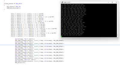

Thank you for explaining how to use the Interrupt structure, I think I understood it a little deeper now. Out of curiosity, is there a document that explains the functionalities and especially their structures (when to incorporate what or which purpose) of the HAL library a little better than the "Description of STM32F4 HAL and low-layer drivers (UM1725)" ? Had several issues when it comes to applying stuff I read in there.
Moving on - I copied your code, inserted my conversion snippet and tried it out:
It seems like most of the time, nothing changed too much - it's still picking up mostly random values. But by moving the sticks on the transmitter, I can occasionally (and not repeatedly) provoke a "valid" frame that leads to conversion and value output. To be fair, that worked before, too.
What I don't understand is this: SBUS is originally "inverted" to 1=LOW (confirmed by two independent sources, yet another one says the opposite). FrSky apparently chose to invert SBUS again to what I figure is 1=HIGH. As per definition, UART is 1=HIGH aswell so I should not need an inverter. It seems like the MCU does receive frames via UART, it just somehow is missing the "00001111" flag as Byte1 of the frame or buf[0] in my code. Is there anything to this I am still missing?
A variant that doesn't check for the start flag and just converts the input to its according SBUS values doesnt give me conclusive behavior:
If filtered by buf[0]=0x0F, the occasional result yields no better values.
Is it maybe signal degradation due to the baud rate being 100k and the bread-board cable I use between the Rx and the STM32 being 20cm long?
Am I totally wrong about UART and indeed do need to use an inverter?
