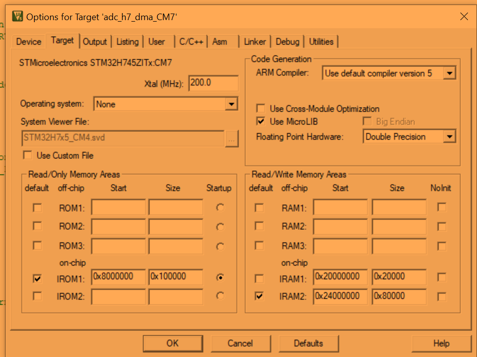

}However, there's nothing to be seen in DMA. I'm using Keil and following the sugesstions in the document above,
I disabled DCache and enabled the AXI-SRAM RAM section at
This didn't work.
