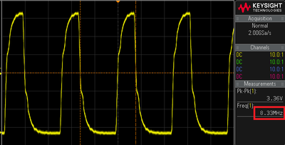

Indeed, you need to set HSE source of your MCU to 8.33MHz as it is a source coming from HSE of the ST-LinkV3 module divided by 3: 25MHz/3 = 8.33MHz.
This is an oscilloscope screenshot probing ST-LINKV3 MCO output and showing the 8.33MHz:

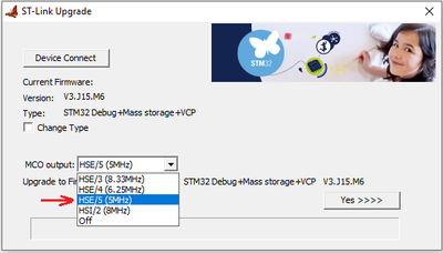

The latest ST-LINKV3 firmware version V3J14M5B5 supports a MCO output frequency of 5MHz (25MHz/5) which is an integer value (HSE as source).
So please use ST-LinkUpgrade.exe tool (downloadable from here) and select 5MHz as shown below:
