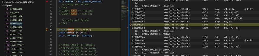

> such a code implementation seems to cause my Stm32F030 to go into Reset_Handler state.
At which line?
2024-03-31 5:55 PM - edited 2024-03-31 6:06 PM
I tried to attach my debugger and I can tell this code is causing reset:
GPIOA->MODER ^= ~(1U<<6);
To be exact, it's command at 0x08000368
2024-03-31 7:50 PM
You'd want to enable the USART2 clock, before writing register.
Check external connectivity to see if that triggers a short or reset.
Doing multiple RMW is also not very efficient. Fold so there's a single load/store instead of multiple.
2024-03-31 8:05 PM
^ means XOR. You probably want &, i.e. AND.
2024-03-31 9:46 PM
It works! Thanks for your help!
