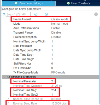

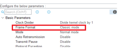

2025-02-24 9:05 AM - edited 2025-02-24 9:06 AM
As you will communicate with CAN2.0 device you need to set FDCAN to Classic Mode. The data phase is no more taken in this case:
And no need to set SEG1 and SEG2 for the data phase.
I've attached an example of FDCAN configuration in Classical mode (CAN clock = 16Mhz) with a bitrate of 125kb/s with a sample point set at ~84%.
Hope that answered your question.

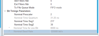

In that case, with CAN Clock = 64MHz in my case, are below valid settings for 125Kbps?
Thanks,
Pradeep

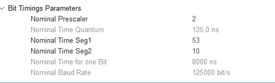

2025-02-24 9:42 AM - edited 2025-02-24 9:44 AM
I would suggest the following settings:
And you need to use an external crystal not HSI as source clock for the CAN.

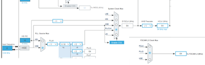

Thankyou for providing settings. I am using external crystal of 8MHz. From 8MHz, PCLK of 64MHz is generated using internal PLL. This PCLK is used as CAN clock. Below is my clock configuration:
Do you suggest to you HSE directly?

2025-02-24 11:39 PM
You can use PLLQ:
