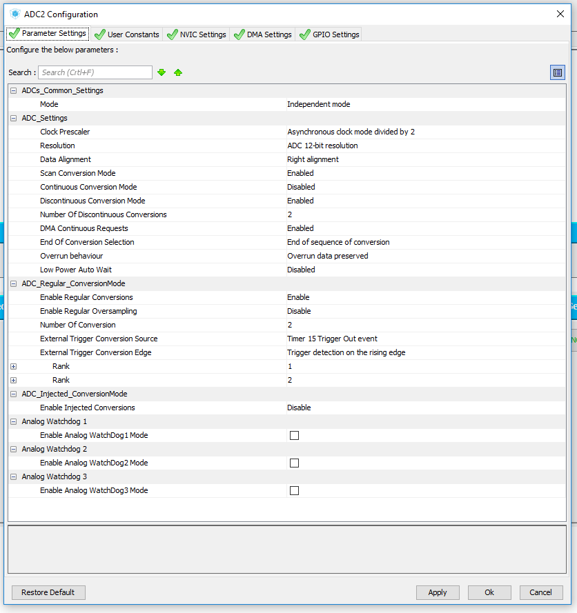

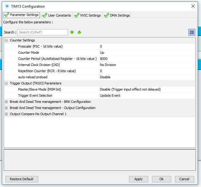

2018-03-15 9:14 AM
This is what my example does. I am using TIM15 to create a trigger for the ADC using the Update Event. This then causes the ADC to sequentially reads 2 channels and uses DMA to put the results in memory. After a number of the DMA sequences have happened I process the data.
