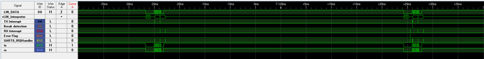

We configured our controller (STM32F427IG) as master and USART8 to LIN-mode. We observed, that the own breaks are detected with the break detection interrupt. Furthermore, we also get the framing error interrupt as the stop bit arrives later for the break. However, the brake is also missed sometimes. I evaluated this and more than one out of 5 breaks is missed. I showed one example below with the LIN-Data, an interpretation of it, the transmit interrupt, break detection interrupt, receive interrupt and error interrupt. Further the transmit-channel and the receive channel of the master are shown. On the left the error interrupt and the break interrupt occur and on the right they are missed. They are either both missed or they both occur.
The signals on the data-channel, rx-channel and tx-channel look fine and one would expect that the break is detected in both cases. The registers are all set according to USART interrupts chapter 30.4 of RM0090 such that the interrupts are enabled.
Do you have an Idea why the break is not detected so often?

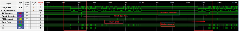

Sorry, that's my bad. I posted the code in its original form. To debug, I added Debug Signals (pins that can be set high or low).
In the original plot the Debug Signal for the UART8_IRQHandler is not shown that indicates that it is not called:

}DEBUG_SIGNAL_1: TX interrupt
DEBUG_SIGNAL_2: Break detection
DEBUG_SIGNAL_3: RX interrupt
DEBUG_SIGNAL_4: Error Flag
DEBUG_SIGNAL_5: UART8_IRQHandler

I still don't like your code :) (see my previous post for comments), but the fact that there's no Rx/FE interrupt prior to Tx/Break makes me think that the problem starts sooner, at the beginning of packet/break transmission...

I thought of a problem with the transmission too and that's the reason for debugging the Tx and Rx channels and showing the plots. However, I cannot see any irregularities when the break detection fails. Or can you think of a scenario where these signals look fine but the detection of the break fails?
