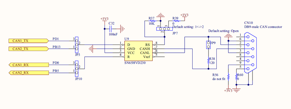

STM3240G-EVAL and STM3241G-EVAL boards have two CAN interfaces (but only one transceiver).
All CAN signals are available on external headers however:

EVAL boards are pretty expensive but the only ones that have onboard transceiver and DB9 connector.
As a much cheaper alternative you may want to go with a
and mount external transceivers such as (just picked up the first Amazon choice, double check if suits your needs).2018-06-12 9:05 AM

Just to be sure I won't make any mistake, if I chose the Nucleo board, I would need to buy 2 transceivers, right (or find one that could take 2 inputs, 2 outputs and send them on 2 different CAN bus) ?
Yes, that's correct. One transceiver per CAN interface.
