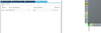

- Another one can be that you have not configured your FATFS "Detect_SDIO" properly:
And then connect one of the GND pins of the SD module of the detect-pin (PA3 in my case) and the other GND pin to GND.
