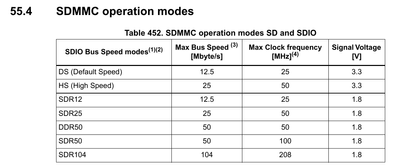

> Clock divide factor: 1 (which results in 200 MHz / (2 × 1) = 100 MHz SDMMC_CK
- is too much ! sd-card max is 50MHz , set div to 2 (or3) , to have max. 50 M .
My SD card actually supports a clock frequency up to 104 MHz, as it complies with the SDHC UHS-I SDR104 standard. when I perform SD read/write operations via the MCU using FatFs, either in blocking mode or with DMA, it works flawlessly even at 100 MHz.
fine, but my H7 needs 1.8V transceiver for this - you have this ?
at 3v3 : 50M max ...
2025-05-22 11:28 PM
You're absolutely right, the SD card may support up to 104 MHz, but without a 1.8V transceiver, we're limited to 50 MHz at 3.3V operation. I’ll stick to 50 MHz to stay within spec.
