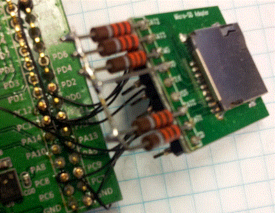

-i use stm32f4 discovery. and i clocked cpu at 42MHZ AND 24MHZ for SDIO . -i just want READING 2MB/SEC AT 42 MHZ . AND READING about 8MB AT 168MHZ. this is my dream - i use your project and read 150KB FILE IN ONE SECOND with 16KB BUFFER. with 42MHZ CPU AND 24MHZ SDIO - sorry i can't answer all your question because i'm beginner and i don't know if your project using dma or what . i use 2gb micro sd and it's reading speed is 5MB/SECOND tested from my computer. my cabel is 10CM with sd adapter like this with 47k pullup resistor.http://3.bp.blogspot.com/-YRk9TlY-nd0/USNnZXgEJeI/AAAAAAAADsI/e8PyI58nWjA/s320/DSCF14JPG

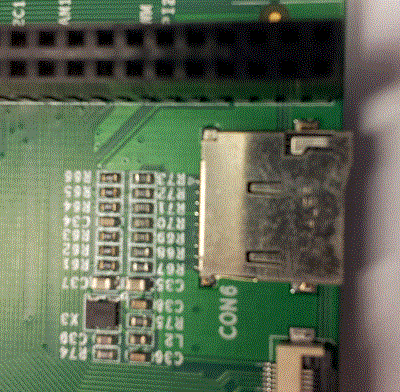

You perhaps want to either clock the CPU >= 48 MHz, or get SDIOCLK (PLL_Q tap) <= 42 MHz You have the wires soldered to a Full size SD Card? or was there something else at the blog spot you wanted to point at? You mentioned MicroSD, and all my analysis/diagrams are for MicroSD. Observations: 10 CM (100mm) is a LONG cable the 47K pull-up need to be at, or proximate to the card interface. I'd want to see equal lengths, closer to 30-40 mm Have you considered using something like thehttp://www.newark.com/stmicroelectronics/stm32f4dis-bb/add-on-brd-base-brd-for-stm32f4/dp/47W1731
