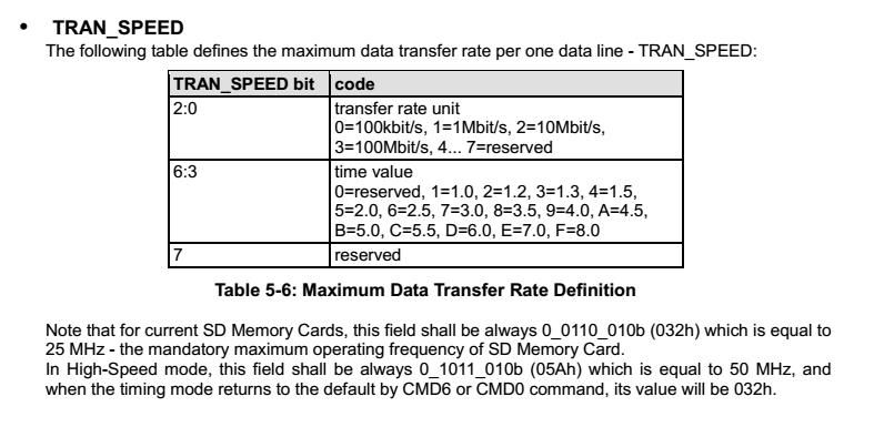

I got value of 50 for
sprintf(card_info,''%.2d'',cardinfo->SD_csd.MaxBusClkFrec); printf(''Card info: '');printf(card_info);printf(''\n''); result :Card info: 50 is it 50MHz maximum for MaxBusClkFreq on this SDcard ? thanks
2014-04-21 12:38 AM
From SD docs Physical Layer Simplified Specification Version 4.10 pag. 116
2014-04-21 8:46 AM
Yeah, I'm not convinced that a card hung off 200mm (20cm) of wire, and poor grounding is going to approach maximal rates, especially in 4-bit mode.
The mechanics of the F2/F4 SDIO implementations tend to be limited to around 24 MHz unless you play games. Most MicroSD cards are rated for 50 MHz operation, full size MMC/SD perhaps half that, but there are a wide spectrum of cards available.What brand/model/rating SDXC cards are you using?2014-04-21 8:52 AM
50 dec = 0x32 hex, so 25 MHz
From 72 MHz a divisor of 3 would get you to 24 MHz, which would be a setting of 1 for SDIO_TRANSFER_CLK_DIV.A more practical approach to validating an SDIO interface would be to CRC32 or hash file data and confirming that matches on a PC and STM32 platform, and that it works repeatedly.2014-04-21 5:07 PM
