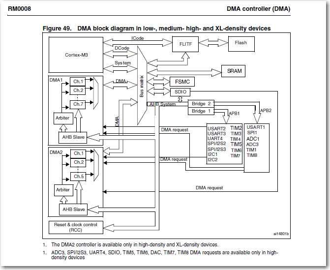

Is it possible for DMA conflict between SDIO and FSMC, since SDIO is using DMA channel4 ?...
I don't know, what do you think the conflict would be? Is there some documentation that suggests there is? Are you DMA'ing from the SDIO to the FSMC external memory. Debugging should have to be about random guessing. Your FSMC configuration is broken, if your read/write parameters are actually different you need to create TWO descriptors, calling FSMC_Init() twice doesn't work that way.
