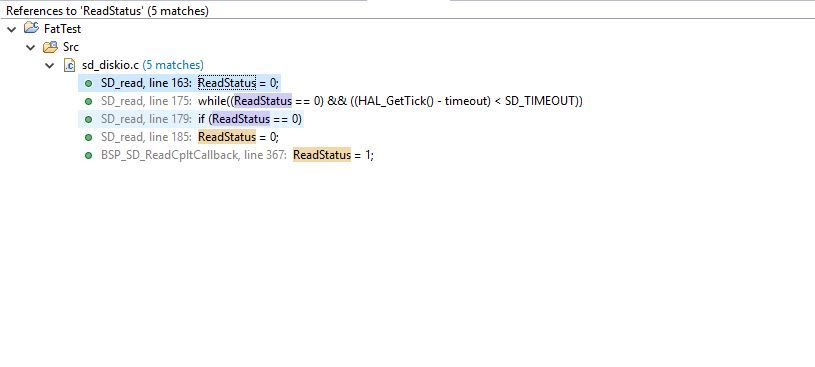

{ res = RES_ERROR; }the function always gets stuck here no matter what. So i went and looked at all the calls for ReadStatus in my project and this popped up:
From here it seems there's one callback that will ensure the SD_Read passes and thats BSP_SD_ReadCpltCallback. Although this is never called anywhere in the project and therefore SD_Read always fails. Therefore it always remain 0 and the LL read function fails. This is cube generated.
Is this a mistake from my side or CubeMX??

2017-11-29 8:34 AM
Thank you, the write function seems fine as it internally sets the write flag to 1, it looks like this was just forgotten in the read function
