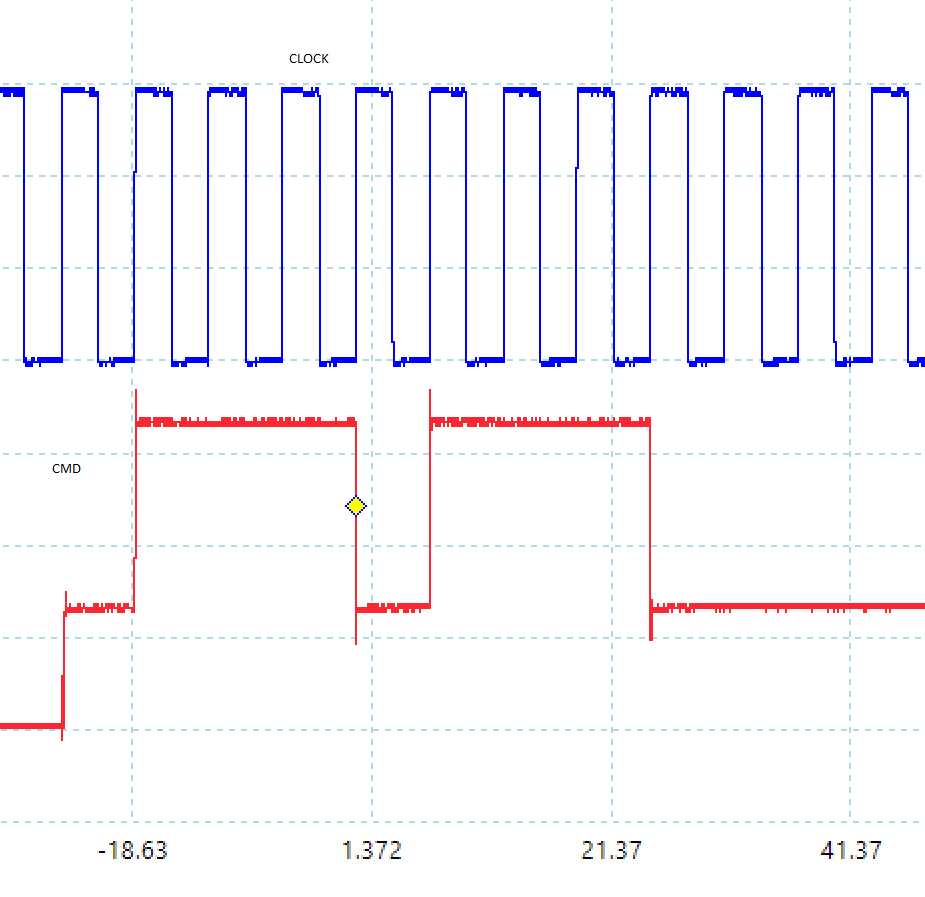

I have then added scope probes to the SD card socket on CLK and CMD lines... I can see the clock fine but no data (on the CMD line) when the code is attempting to send the command.
Possible Cause
I have then placed the probe on the CMD line input to the M1 module card (that has a IP4856CX25 isolation type chip)... Now I can see CMD data travelling to the IP4856CX25 but not onward to the SD Card..... Aha!... The signal also does not look nice (looks like bus contention). It looks like maybe the code from the STM32Cube wizard has no awareness of the IP4856CX35 isolation chip? That said... The code has provision for I/O pins CKIN, D0DIR, CDIR, D123DIR and D0DIR in HAL_SD_MspInit()... All of these are pins specific to the IP4856CX35.... But what is setting the SEL and ENABLE lines on the IP4856CX35...
I have isolated the problem to the transmission of data through the IP4856CX35... The CMD data is not getting through and there looks to be contention on the CMD line.... Any wisdom is greatfully accepted!
Here is a scope grab, showing CLK (at the SD card connector - blue) and CMD (at the input to the IP4856CX35 - red)....

It looks like the ST generated code does not set the hsd1 structure quite right for the board... The board has an SD tranceiver, so I have changed the code in MX_SDMMC1_SD_Init() as follows:

}Now I can see the CMD data getting across to the SD card itself.... Still getting timeouts following CMD55 transmission. Again, wisdom would be appreciated.
