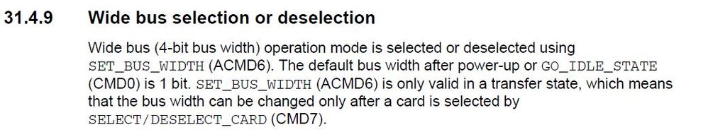

I have double checked all connections of SD card socket to uC on our board. We also have pull-up resistors there. Required setting of 4-bit access can be seen in the SDIO_CLKCR.WIDBUS register during debugging but function disk_initialize called in f_mount retutns FR_NOT_READY. Any opinion? However, it is suspicious that I had to increase the SCLK divider to low the SCLK frequency for a reliable work (in 1-bit mode). Regards Ivan2015-01-19 1:03 AM
Hi Ivan,
The 4-bit SD Data Transfer Mode is Mandatory for High-Speed Cards, Optional for Low-Speed ones, so it depends on the used uSD card type. Otherwise, it's better to configure first the 1-bit SD Data Transfer Mode:hsd.Init.BusWide = SDIO_BUS_WIDE_1B;
And then, just enable wide operation, for the 4-bit SD Data Transfer Mode:
HAL_SD_WideBusOperation_Config(&hsd, SDIO_BUS_WIDE_4B);
