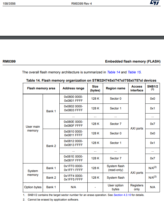

@Lucifer37 wrote:STM32 Flash
| source code | 0x08000000
| code End |
|-------------------|0x0800F000
| Config data |
-------------------|0x080FFFFF
0x800F000 falls in the middle of a Sector:
2024-10-24 5:08 AM
THANKS FOR ALL YOUR REPLIES, @Andrew Neil @Tesla DeLorean
Just help me understand this :
MEMORY
RAM_D1 (xrw) : ORIGIN = 0x24000000, LENGTH = 512K
FLASH (rx) : ORIGIN = 0x08000000, LENGTH = 512K /* Memory is divided. Actual start is 0x08000000 and actual length is 1024K */
CONFIG_DATA : ORIGIN = 0x080E0000, LENGTH = 128K
DTCMRAM (xrw) : ORIGIN = 0x20000000, LENGTH = 128K
RAM_D2 (xrw) : ORIGIN = 0x30000000, LENGTH = 288K
RAM_D3 (xrw) : ORIGIN = 0x38000000, LENGTH = 64K
ITCMRAM (xrw) : ORIGIN = 0x00000000, LENGTH = 64K
.configdata :
. = ALIGN(4);
*(.configdata*)
. = ALIGN(4);
} >CONFIG_DATA
with this I'm able stop CONFIG_DATA from Erasing/untouched, or I should use NOLOAD/NOINIT ?

I don't know exactly how CubeIDE decides what memory is its to erase.
As @Tesla DeLorean also mentioned, one way is to simply manage it yourself to ensure that your data is beyond what gets used by the code.
I think that just reducing the FLASH size in the MEMORY section would do that?
eg,
MEMORY
FLASH (rx) : ORIGIN = 0x08000000, LENGTH = 384K
So that the tools "think" that there is 128K less than is actually present - and, thus, will never try to erase it.
You then manage placing the data in that top 128K yourself - as previously described...
