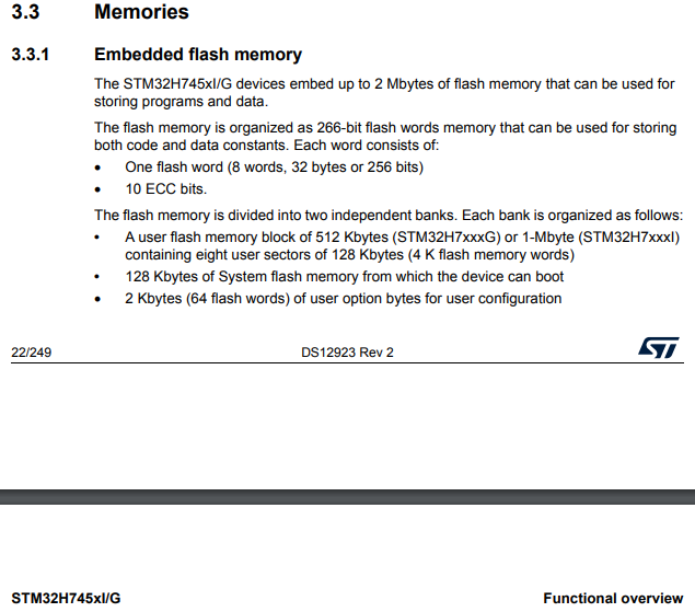

@Lucifer37 wrote:I'm using STM32H745
Which one?
https://www.st.com/en/microcontrollers-microprocessors/stm32h745-755.html
eg, for STM32H745xI/G:
https://www.st.com/resource/en/datasheet/stm32h745zg.pdf#page=22
