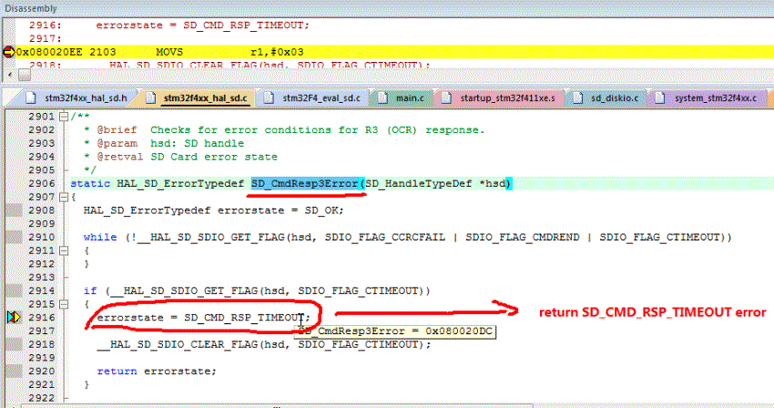

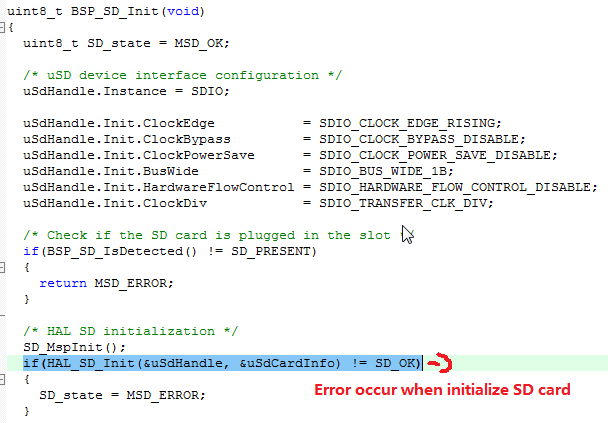

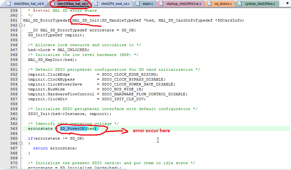

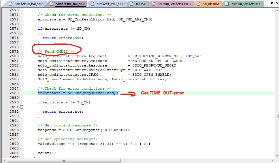

Now I test the uSD. Find there is problem in
2015-10-21 5:36 AM
I really have no insight into your board design, or clocks. Right now it kind of suggests a connectivity issue with the SD Card, and perhaps clocks.
I can't help you with HAL stuff, and whether that works out of the box, or not.2015-10-22 4:19 PM
Maybe it is caused by speed. When I debug one line by one line, it seems OK.
How can I reduce the SDIO speed? Thanks2015-10-22 8:09 PM
The primary clock is from the Q tap of the PLL, the one controlling the bus is the ClockDiv parameter for the SDIO. The initialization speed is 400 KHz, and most microSD cards should be clockable at 24 MHz
