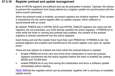

2023-12-13 12:51 AM - edited 2023-12-13 12:59 AM
It is possible to make changes of frequency and duty cycle of a HRTIM without resetting the pwm or introduce glitches?.
To change the period and duty cycle I should do:
HRTIM_TimeBaseCfgTypeDef pTimeBaseCfg = {0};
pTimeBaseCfg.Period = 2892;
if (HAL_HRTIM_TimeBaseConfig(&hhrtim, HRTIM_TIMERINDEX_TIMER_A, &pTimeBaseCfg) != HAL_OK)
Error_Handler();
HRTIM_CompareCfgTypeDef pCompareCfg = {0};
pCompareCfg.CompareValue = 1446;
if (HAL_HRTIM_WaveformCompareConfig(&hhrtim, HRTIM_TIMERINDEX_TIMER_A, HRTIM_COMPAREUNIT_1, &pCompareCfg) != HAL_OK)
Error_Handler();
But I do not know if the changes are done in the actual PWM cycle or in the next.
If not, the second option is to change both at the begin of a cycle (shot by an interruption at the beginning of the timerA)
2023-12-13 1:40 AM
rtfm

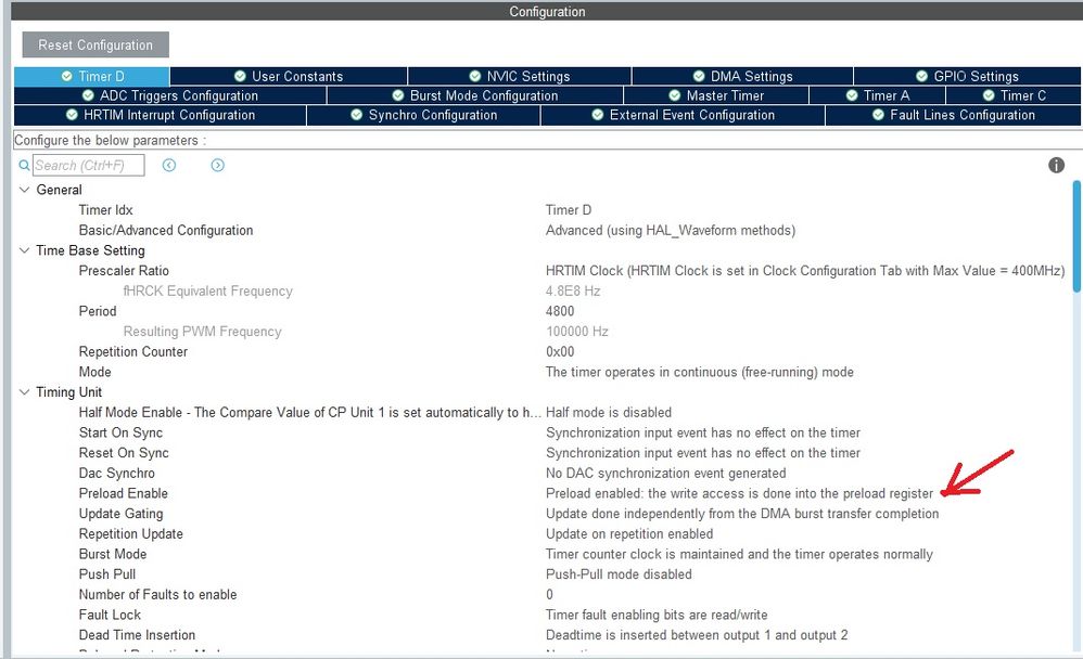

2023-12-14 12:58 AM - edited 2023-12-14 2:09 AM
I found it at the stm32cubeide:
By default it is disabled.
In other way how to manage the complementary mode?, I have programmed the timer D-1 and 2, if I make push-pull I can not set the dead time. With dead time I do not know if it is connected the timer D-1 with compare unit-1 and timer D-2 to the compare unit 2 and if it is delayed pulse of the D2 automatic
I run the code but no signal is generated. Seems that something must be done to make timers run or activate the lines, something like this but for stm32h7xx:
LL_HRTIM_EnableOutput(HRTIM1, LL_HRTIM_OUTPUT_TC1 | LL_HRTIM_OUTPUT_TC2);
/* Start HRTIM's TIMER C */
LL_HRTIM_EnableIT_REP(HRTIM1, LL_HRTIM_TIMER_C);
LL_HRTIM_TIM_CounterEnable(HRTIM1, LL_HRTIM_TIMER_C);
Exist an example code?
