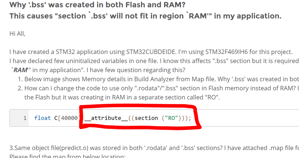

Correct me if i'm wrong. Here 672.9KB of my code sections resides in FLASH memory .
My assumption is that at the runtime, entire code section will be loaded into RAM. This is usual behaviour when I work with micro-processors(DISK to RAM). I feel the same with Micro-controllers (FLASH to RAM).
In my case,STM32F496IH6 has only 320KB RAM. And I feel it's impossible to fit 672.9KB data from FLASH to RAM.

Hi @TDK ,
If CPU directly run instructions from FLASH then ideally there will no issue with code size. I will try to figure out why my application was not running in RELEASE mode and let you know if I find a solution.
In second paragraph, you mentioned uninitialized variables are not stored in FLASH. But it seems not true. Uninitialized variables are resides under .bss section. And this will be created in both FLASH and RAM. I posted one question similar to this. Please take a look at map file from this post.
https://community.st.com/s/feed/0D53W00000FzIanSAF
In the MAP file you can see .bss section was created in both FLASH and RAM.
2020-08-21 8:54 AM
Obviously if you tell it to be stored in the read-only section, that is where it will be stored.
You're telling it to store an uninitialized, non-const array in a read-only section, which is nonsensical.
Remove the attribute, use a default linker script, and it will indeed not store uninitialized arrays in FLASH.

Hi @TDK ,
I have not used any attribute and I have default linker script only. Not changed explicitly anything.
Also, Did you get a chance to look at map and linker filers in above mentioned link?
If you see the map file, it has .bss sections created in both FLASH and RAM.
One of us is definitely missing something.
We're just running in circles now. I think my first couple of replies to this post is about all I can help.
You're trying to use FLASH as RAM. You can't do that.
Good luck.
