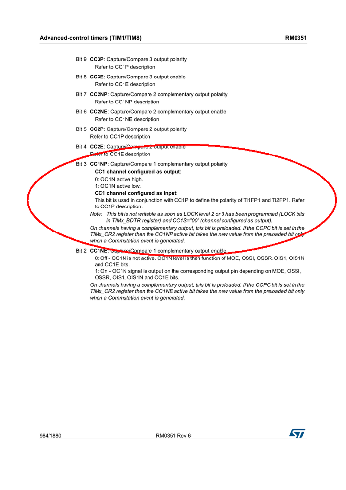

After end of the burst, set TIM1_CCER.CC1NP, and before beginning clear it again.

what is CC1NP?
