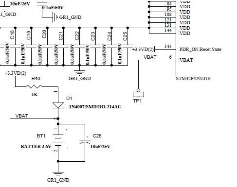

Maybe help show schematics, seems as your BAT connection have an issue

Is this schematic Ok?? or am I doing something wrong?
2021-11-25 10:17 PM
The nominal voltage is 3V and the voltages in the discharge curve are in the range of the acceptable voltage range of Vbat pin as mentioned in the datasheet i.e. 16V to 3.6V. Theoretically, it should work but it is not working and I do use other controllers from ST i.e. STM32F103xx and STM32F107xx as well they are not displaying any issue as shown by this controller. This problem is only with STM32F429ZIT6. I have attached the schematic below for refrence. Please do let me know if i am doing someting wrong.
