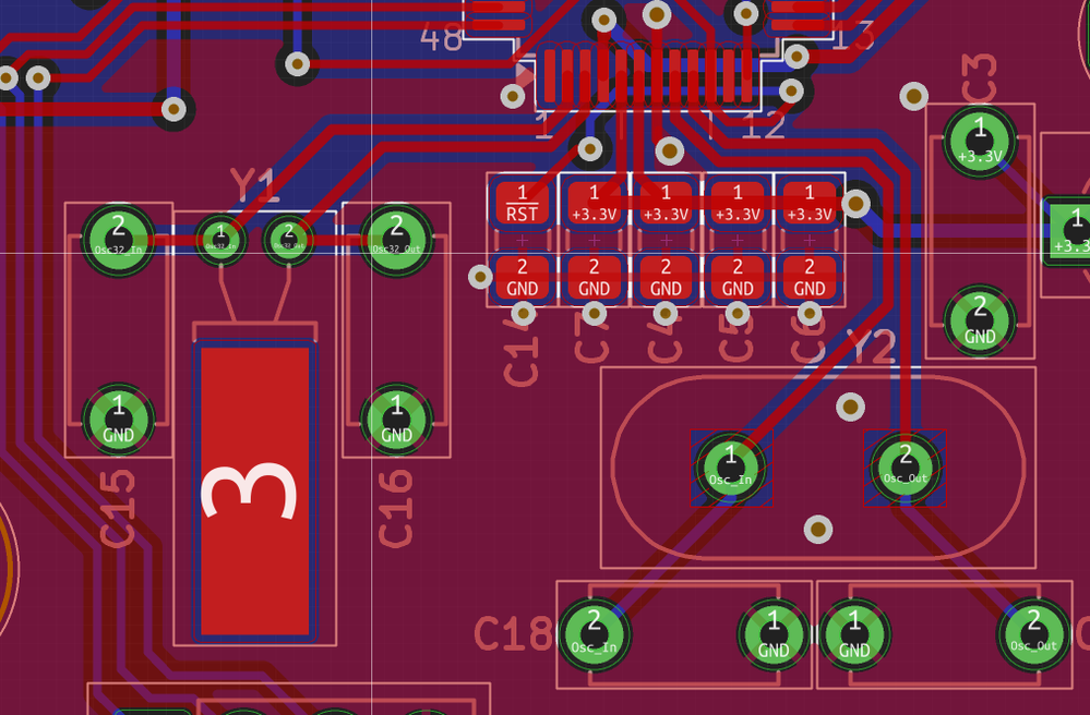

Tell us more about yor hardware. Show layout of LSE oscillator, including ground arrangement.

In this MCU pin 1 is RTC_OUT1. Originally I didn't consider the RTC_OUT pin, so that there's not connection over it; however, I'm getting it through a wire. It must not affect the output frequency because it's supposed that the crystal circuitry is isolated from the pin.
Board is two layers with a massive ground planes in both of them as can be seen.

Don't use the common ground plane to return from the capacitors around the crystal; use a dedicated track as short as possible. Read AN2867, pay attention to the provided layout example.
Due to the PC13-related erratum, there may be no solution to given problem, as long as you stick to that pin.
