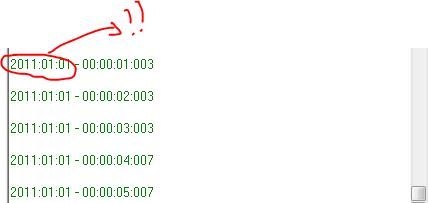

1- Problem with correct Date display ( Issue appears when I use Binary format instead of BCD format) :
In fact, I have followed the RTC_TimeStamp example provided by STMicroelectronics within its STM32L4xx HAL package.
In this example, we do use the BCD FORMAT while setting date and time and we do use the BIN FORMAT when getting date and time.
I have tried to do so with my project. My date and time are 2017/01/01 - 00:00:00 which have the corresponding POSIX value 1483228800.
When I use binary format ( BIN format ) to get the date , I found 2011/01/01 as date value ( which is obviously wrong. Now, as first step I have switched to BCD format for getting the date and I have the right date value which is 2017/01/01
(see attached capture named ''Date_with_BCD_format''). So, as an initial deduction, I might asked if there's a problem with the way ST converts date from BCD
to BIN through its HAL APIs. After debugging, I found that ''RTC_Bcd2ToByte'' function used by ''HAL_RTC_GetDate'' is returning a wrong value.
Can someone confirm this behavior ? Maybe there's something missing with my configuration ?

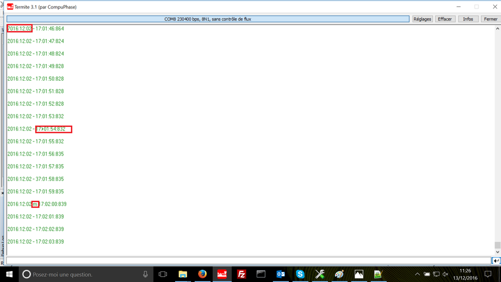

3- Strange values displayed :
I have found another issue with my RTC when I leave my application running for too long. In fact, some strange display figure out (see attached capture named ''Strange Display'')
What could be the reasons for such behavior ?
PS: For displaying the RTC time and date values , I am using UART connection with Termite 3.1 SW.
