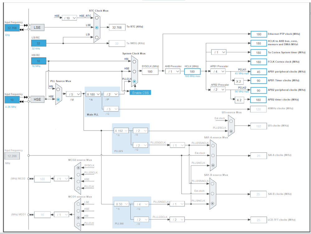

Something is wrong with the clocking and i cant figure out. When i try to debug with step over,
the error handler in void SystemClock_Config(void)
Error_Handler();
Takes me to
/* Wait till LSE is ready */
while(__HAL_RCC_GET_FLAG(RCC_FLAG_LSERDY) == RESET)
if((HAL_GetTick() - tickstart ) > RCC_LSE_TIMEOUT_VALUE)
return HAL_TIMEOUT;
in hal_rcc.c. where i am forever stuck.

Which STM32?
What is the hardware? Is this a "known good" board such as Nucleo or Disco, or your own?
2021-09-09 1:45 AM
Discovery F429i
2021-09-09 2:06 AM
The LSE crystal is probably not populated by default, including its surrounding circuitry (capacitors, jumpers). Read OSC 32 kHz clock supply chapter in UM1670.
