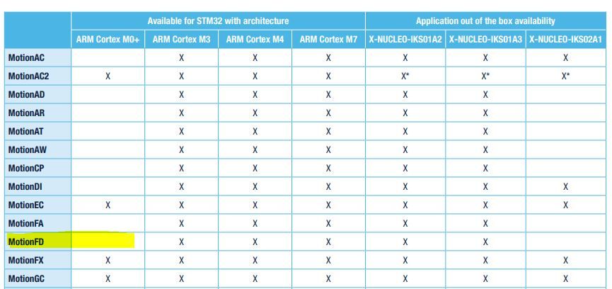

Does STM32L083RZT6 support motionFD library?

Hello @jason239955_st​ ,
The motionFD is not supported for STM32L0.
So far MotionFD library is not provided for Cortex-M0.

jason239955_st
Associate III
Thanks for the answer.
