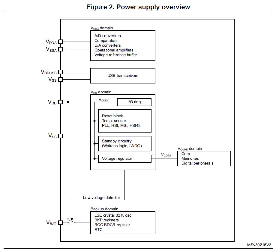

I am considering to use Nucleo-L432KC board and I need to use it's RTC with maintained time. User manual shows Vbat power in some internals of MCU but there is no pin to provide this power. Looks like the main chip's power source Vdd is the only source powering RTC block. Consequently Nucleo32 board with it also does not provide battery power for RTC backup even though it does have a crystal for RTC. Does this mean that RTC built in this MCU was not meant to be maintained in off-power mode and must be setup after every power-up or is there something I am missing?

Something was meant by the developers by devising the internally generated power shown as Vbat for the RTC module. What is the idea behind that? Why did they show Vbat if there is no functionality associated with it? Look at the Power supply overview picture from STM32L432 - see Vbat ? (Or is this picture pasted from another MCU datasheet ) How the user suppose to use this information?

Hi
tech.008
,There is a typo in STM32L432Kx devices as there is no VBat pin in low pin-count packages. We say this explicitly in
:VBAT is internally bonded to VDD for small packages without dedicated pin.
VBAT pin is not available on low pin-count packages, VBAT is internally connected to VDD.
The datasheet will be updated to fix this error.

Thank you Amen for clarification. This also implies that all the efforts of STM developers adding RTC provision to the tiny Nucleo_L432 board by allocating RTC crystal is usable only for the duration of the power ON. Since RTC clock does not keep time after power-off, RTC must be reset to a real time after each power-on... Not really a full RTC implementation without ability to keep time...
