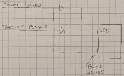

Here's an example
The diodes will "choose" between the Main & Backup power.
The 'Power Sense' input to the STM32 allows it to "see" when Main power is available - if the Main power is not available, it can conclude that it must be running on Backup power.
Note that this has nothing really to do with the STM32; this is general to anything that has Main & Backup power - it's a power supply design issue, rather than an STM32 issue.
"Power Path" would be a good search term ...

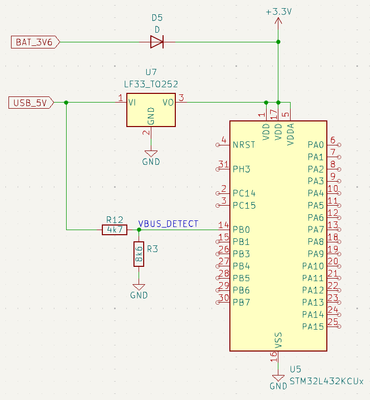

Hi Andrew,
something like this one?
PB0 (vbus_detect) report information when 5V is present or missing. If missing power from USB, MCU go in STANDBY, when power return MCU exit from sleep on 'PIN change'. Is it correct?. Any better schematic solution? Which chip can do this? Thanks
2025-02-06 3:45 AM - edited 2025-02-06 4:19 AM
When the USB power is removed, that will apply battery power to the output of the U7 regulator - which may not be a good idea ...
What kind of battery is it? Does it need charging?

2025-02-07 12:19 AM
You are right, powering the LDO from the output could damage it and would probably consume more than the STM32 in standby mode.
For years I have been used to using packages with a limited number of pins, so I immediately chose the 32-pin version.
However, it doesn't make sense to complicate my life, so I will use the 48-pin package, which has VBAT and is the same size as the 32-pin one. There will be some unused pins. I'll just have to accept it! ;)
Thanks for your kind support.
