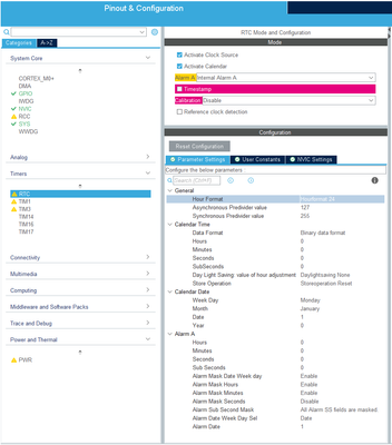

I have found various guides on how to configure the RTC as wakeup-source. However, they do not seem to apply to the C0 family.
In the CubeIDE I cannot find the depicted settings on RTC, (most notably, no option to select internal wakeup and configure wakeup counter and clock)
Is this not implemented on the C0 family?
I just want my MCU to wake up from sleep mode every x milliseconds. What else can I do to implement this on a C011?
Thanks
Lucas

Let's switch from register level to a STM32CubeMX generated project using HAL.
Generate a new project, I used STM32C0116-DK for example with all default settings.
Activate a periodic RTC alarm once per minute, date and time don't matter.
The generated code will already activate that alarm in MX_RTC_Init();

One more question regarding this topic:
How can I set a different time?
My RTC Init looks like this

I've already changed the IOC so that "Alarm Mask Seconds" is alos enabled. Now it flashes once per second, not per minute. But how can I set a custom time? I tried playing around with the RTC Init but could'nt achieve a different timing.
Ideally, I want to use it in the subsecond domain (to get the MCU to sleep for a few us every time) but I guess the logic is the same once I understand how it's done.
Thanks
Lucas
