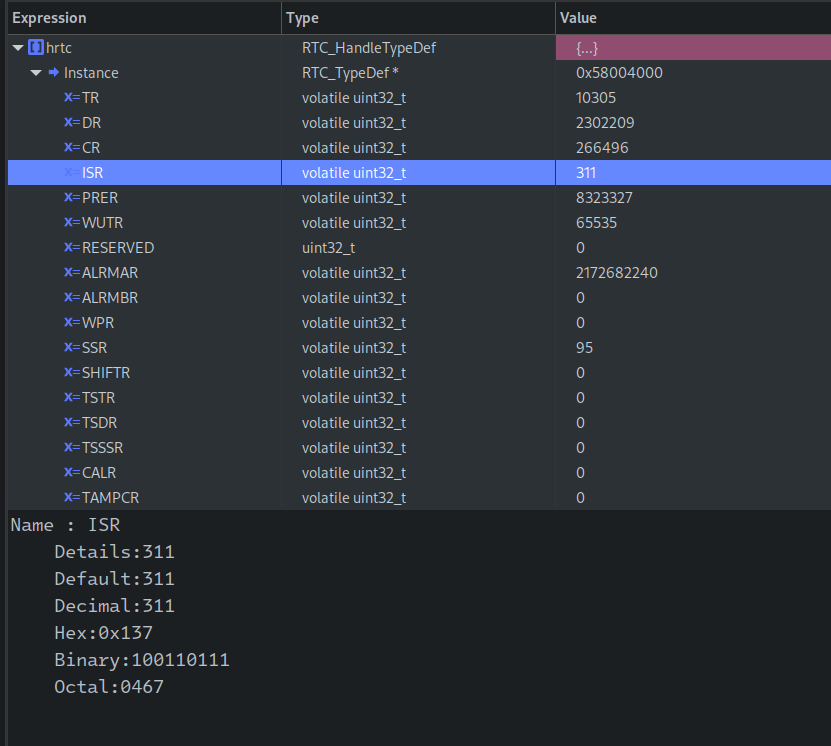

I have the alarm being triggered every 1 minute. I can see the alarmA flag and try to clear it with this macro:
__HAL_RTC_ALARM_CLEAR_FLAG(hrtc, RTC_FLAG_ALRAF);
But the ISR register is unaffected.

2023-10-02 5:18 PM - edited 2023-10-02 5:20 PM
I still have nothing. Seems like the HAL functions to perform all the actions called for in the datasheet.
ISR Flag does not clear:
Still can only get a single interrupt. Single alarm handler, that's it..... Please advise.
