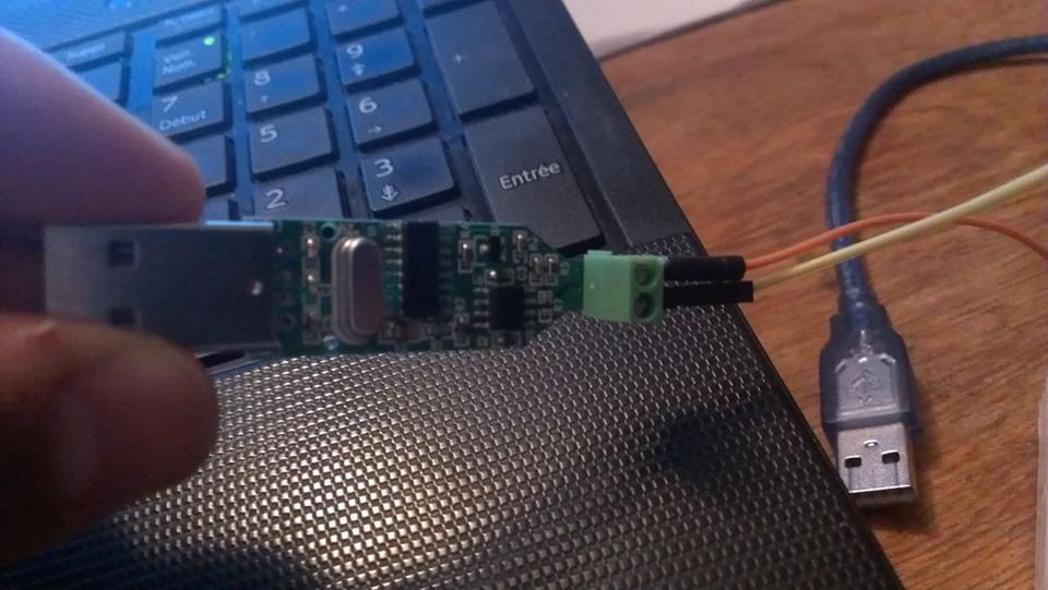

i declared as information to send a uint8_t with a value 0x22 or 0xBB
i'm using half dubplex and i putted DE and RE to High level (to use max485 as transmitter ) i added a picture of my RS485/USB adaptaer, it's small circuit wich use a MAX485 and CH340Gthank you for the reply
