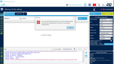

I'm from an institution where we use STM32 as our regular teaching material. But I have noticed that many of our boards are getting this issue, Even though it's physically perfect. This is making a lot of ewaste for us. I have tried all the method searching in Goolge
(for example: using the reset button while pressing connect)
But all these are not helping us.
Could you tell me why this are happening and how can I troubleshoot if a board has encountered such an issue. As we are a large customer for this board, this error is causing a lot of fund issue. could anyone help to trouble shoot this.

I have tried updating the firmware, and the board also has been powered. I almost tried everything that I couldfind in a basic web search. But still the issue's there.
