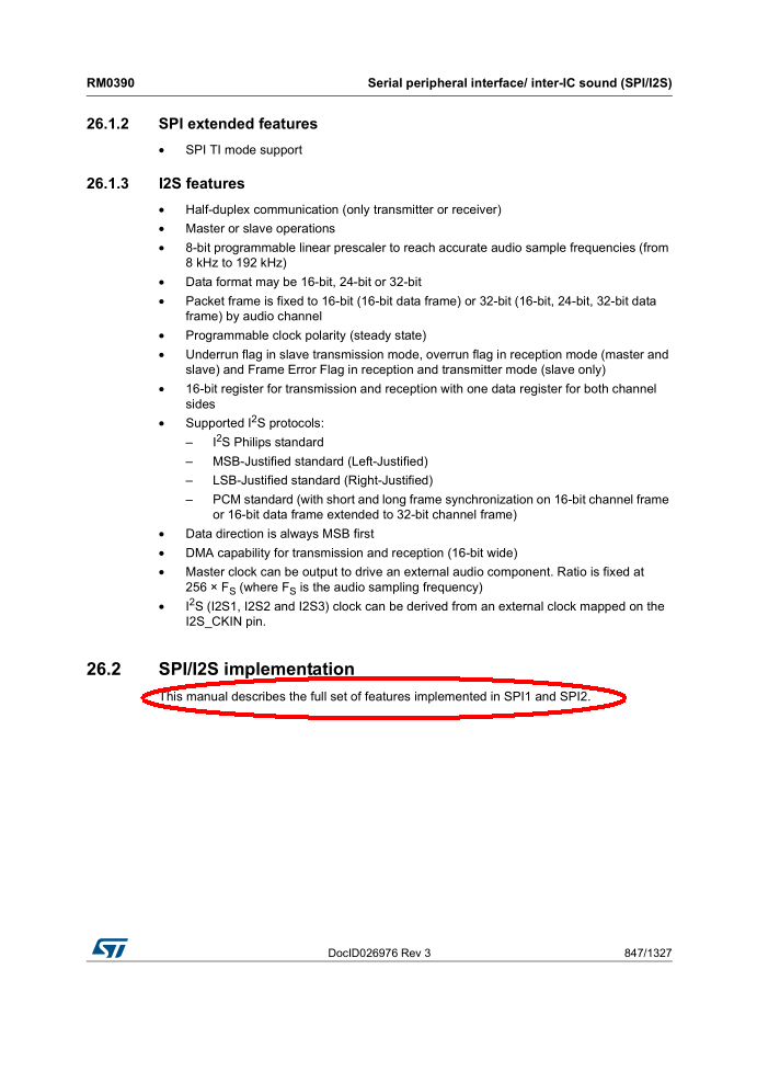

The 'F446 according to DS has SPI1 to SPI4, and SPI4 does not implement the full set of features (I2S missing).
2017-09-13 6:35 AM
Thank you
Waclawek.Jan
foryour feedback. I confirm this missing andraised it internally.Kind Regards
Imen
2017-09-13 6:35 AM
Thank you
Waclawek.Jan
Imen
