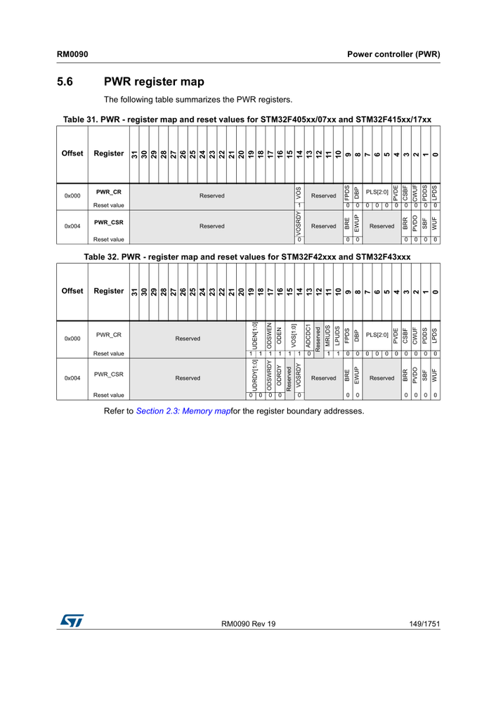

Comparing by experimentally read out fvalue I found the table value is incorrect, and the value from the PWR power control register (PWR_CR) for STM32F42xxx and STM32F43xxx subchapter appears to be correct. However, it says:
Reset value: 0x0000 C000 (reset by wakeup from Standby mode)
Why the "reset by wakeup..."? And what's the expected reset value after POR or system reset, then?

Hi again,
Ticket 135742
Thank you !
