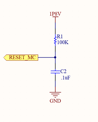

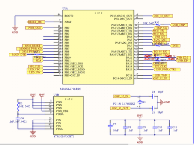

Custom board? Show circuit. BOOT0 pin doing what?

The device has bootloader in 08000000 and program in 08001C00. There is no silent while(1) loops.
BOOT0 pin is connected to ground.
