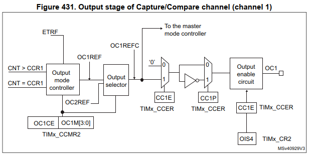

Sorry, by "wait to be triggered again" I meant wait for CNT to reach CCRx again. That is, does OCxREF keep state behind the output mux? Or does forcing the output compare output to inactive clear OCxREF as well?

Okay, thanks, that answers my question. This is the diagram shown in the reference manual:
What I called the "output mux" is labeled "Output selector" here. Or that plus the rest of the chain.

I see.
That "selector" basically performs the AND/OR with a neighbouring channel's output in the Asymmetric and Combined modes.
The latching happens in "Output mode controller".
This is an evolutionary thing. Compare the same diagram in older STM32's RMs, e.g. RM0008 (that's for 'F1, the oldest).
