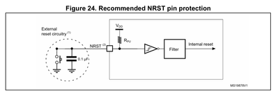

Generally , Reset pin by default status is Logic High.
But in AN4206 ( Page 31) , NRST pin is not Connected to 3.3V , it is left Floating with Capacitor.
Is that Okay ?

Yes, the typical connection is floating with 0.1 uF cap. It is internally pulled up.

Would it Enable By Default or any Configuration Needed ?
Would it be Good Idea to pull-up NRST pin Externally as well ?

I think you're good to go.
Optionally, if you don't need to bring the internal reset out, you can make this pin GPIO.
Check the "FLASH_OPTR" register.
Though I dare not say if the internal reset state is fully reliable.
We have an external pull-up, just to be safe.

One concern with ext.pull up is , it may paralle with internal pull-up to reduce resistance. In my case , ext pull up will be 10k. We want to keep Reset function for USB DFU Bootloader.

No configuration needed.
Pulling it high externally does not add any functionality. It is unnecessary.

I would use an external pull-up for EMC reasons, if the reset line is connected to other IC's on the board. (The PCB track is like an Antenna for EMC, and can generate an unwanted reset).

The 0.1 uF cap protects from parasitic resets, not the pullup.

True, but not entirely if the EMC signal is amplitude modulated (as a lot of Standard test's require).

The extra pull-up may be superfluous, but as the ball is already drawn out for the cap another resistor will not bother me. Later, the bean-counting army can get a bonus for removing it from the BOM.
BTW, our work-in-progress design (G4) omits the reset line from the SWD connector.
I have not found any situation that kills the connection yet but a TP may save the day some day.
Without full control over the supply I'd be more conservative though.
