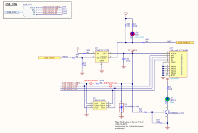

HI @Aldo_Flores_Aguayo
PA9 is a five volt-tolerant pin, including an additional function natively dedicated to VBUS sensing.
The absolute maximum ratings table of the datasheet indicates that the five volt-tolerant pin voltage cannot exceed VDD+ 4V.
You can check the schematics of STM32L4P5 Disco board provided as reference:
Best regards,
FBL
