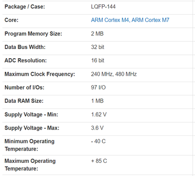

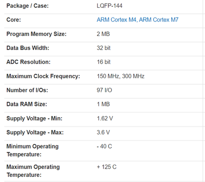

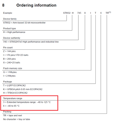

Thanks for the information. I am specifically looking at the LQFP144 configuration. I noticed that both the STM32H745ZIT3 and STM32H745ZIT6 microcontrollers are available on Mouser.com. However, I am confused about the differences between the two. What do the suffixes ZIT3 and ZIT6 mean?
Additionally, I saw on Mouser.com that the ZIT3 supports a temperature range up to 125°C, while the ZIT6 supports up to 85°C. This seems contradictory to what I expected. Could you clarify the correct temperature ranges for these models?
Lastly, both processors are listed as having Cortex-M4 and Cortex-M7 cores. Is this information accurate?

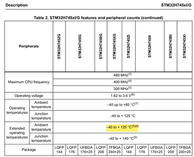

For your last question, you need to refer to the datasheet:
In summary:

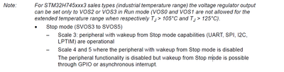

3 is the industrial line and you can reach 125°C without exceeding 300MHz @VOS2.
6 is the "regular temp range" and you can't exceed 85°C but you can reach 480MHz @VOS0.
So it depends on your application and on which environment will be deployed.
These are dual core processors that have both an M7 and an M4 core. There are also single core STM32H7 chips that only have an M7 core.

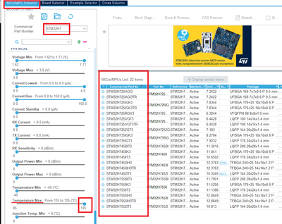

Can you provide the list of single core STM32H7 with higher temperature range >105 C. I couldn't find it in mouser.com. Thank you!
2024-09-04 10:30 AM - edited 2024-09-04 11:15 AM
You can use CubeMx for that:
2024-09-04 12:00 PM
STM32H725 and STM32H735 are the only single core STM32H7 chips with up to 125 C operating temp.
