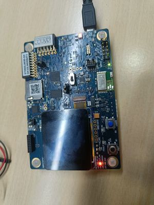

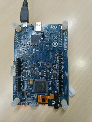

Hey im trying to blynk led on stm 32 l562e dk board i had attached the consol logs its not connecting to debuger i want to ask you is their any default jumper settings for this board or is their any specific debug settings required for this board . i had also attached photos of my jumper setting. additonally i had also attached my code. its a brand new board i just orderd .

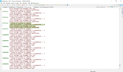

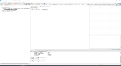

2024-08-26 2:57 AM
I had some how fix that error now im facing this issue how can i solve it

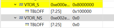

2024-08-26 6:13 AM
Looks like the vector table might not be set correctly. Ensure SCB->VTOR points to the right place, typically the start of FLASH. The SFRs window can be used to view register values (Window -> Show View -> SFRs), or add them as expressions.

2024-09-01 1:14 AM
no i cannot debug the application yet you can see my scb vector values in the below immage i had tryed creating multipal project also tried with blank project its not working i get the same error as i showed above.

when i click on dissassimbly its gives me this output .
2024-09-02 4:26 AM
But you succeeded to connect to the board as we can see VTOR_XX in the debugger, right?
2024-09-02 4:41 AM
Yes i can connect to board but the code is not running its shows wating for debuger even in blank project its happening.
2024-09-02 4:43 AM
Usually when you press debug button it should set brakepoint to main and start running after clicking on resume button its not happening it's getting stuck somewhere
