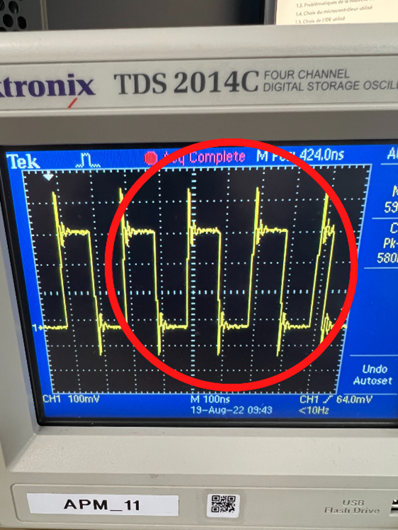

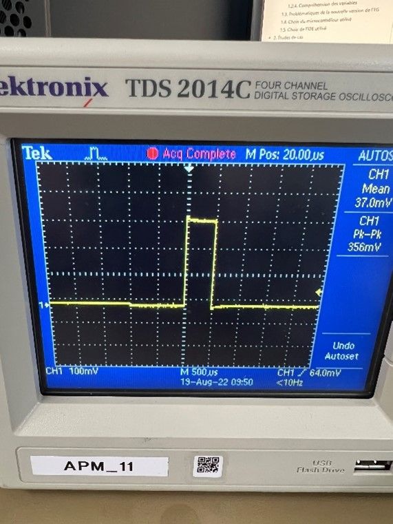

I created a program that should create repetition on an arbitrary waveform through DMA burst feature. I use circular mode and I decide to stop it when the repetition are done. I use the transfer complet interrupt to increment a variable to have the repetition wanted.
My problem is that I get different results for a different magnitude. For example, when I set a PWM signal of 1s with a duty cycle of 50 %, the program is working. But when I used a signal of 200ns with a duty cycle of 50 % it's not working.

Here is the picture of the 1s signal
Here is the picture of the 200ns signal, you can see the uncessecary repetition that make me think of delay of time execution in the interrupt routine (I should have had just one repetition)
Here is the code, for the initialisation counter =-1 and repetition =0 because I want 0 repetition

Which STM32?
200ns is too little time for ISR to execute even in the fastest mcu. Find some other way to stop the pulsetrain. The simplest and probably the best is to use non-circular DMA.

As JW said, I think you need to find another way to stop the pulse train - but in the mean time, I think you could pulse an io pin (efficiently using the BSRR register) within the interrupt routine (eg. set pin high at start and low at the end of the interrupt routine), then you can get a better idea of when the interrupt routine is occurring in relation to your pulse train.
