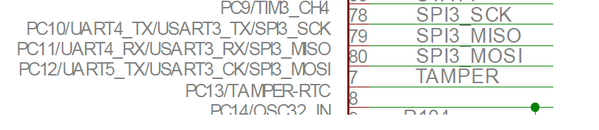

I am working with the STM32F107 chip on the STM32F107VC board from IAR.The evaualtion board has an LCD which has as its inputs SPI3_MOSI and SPI3_SKC. But since it needs to have 9 bit inputs, i can communicate with the LCD either by manuallybit-banging or USART (which has a 9 bit output option).
But according to the datasheet, i can only remap USART3_SCK to SPI3_MOSI and USART3_TX to SPI3_SCK.First of all, i can not understand, what the purpose of the above remap option can be. Is there a way, I can remap the TX of any USART to the SPI3_MOSI pin (and the Clock signals respectively)?I hope to get an answer. If USART to SPI is not possible with STM32F107, I will do bit banging, not to loose any more time.I am very new at embedded programming and this is my first post. I am sorry if i did not follow any rules or forgot gave any necessary information.Thanks in advance. #spi-usart-stm32f1072012-08-22 12:35 PM

After reading the responses, I thought that it is not possible to control the LCD over the 8/16 bit SPI peripheral (by using dummy bytes etc). Reason i thought of was, that if a SPI-RX expects 9 bit SPI data, the SPI-Tx needs to send 9bit data (the Atmel Controllers with ARM processor have the 9 bit option). Unfortunately, from the Epson Datashet (in the attachement), I can not read it directly out, if the Microcontroller is clever enough to wait for the completion of the inputs, and then stores valid data for representing a pixel into its RAM or issues a respective command. Unfortunately, i spent my time understanding the material instead of experimenting, but this is what I will do next. But to summarize: 1- You confirm, that in deed if the mapping to the SPI3_MOSI (Pin 80) and SPI3_SCK (Pin 78), which is as following picture (this is from the IAR Board Schematic but the same is in the Datasheet of the STM32F107), does not allow mapping USART3 to them?2012-08-22 5:18 PM

Hi Clive,
again thank you for your response and thanks that you throw an eye on the EPSON manual in the attachements.I understand with what you mean by the CS Pin and i will keep experimenting.What I did not understand was what you meant with ''The 9-bit USART might be usable, but again you have to deal with -CS pin.''If the mapping of the USARTs to the SPI is as in the caps above, how can you use them? How can you use the USART_Tx on the SPI_SCK or the USART_SCK on the SPI_MOSI?I fundamentally can not understand that.Does not this configuration basically kills the option of using USART on SPI?Thank you.2012-08-23 10:21 AM
I don't think the USART is at all practical in your circumstances, in the other thread I don't think they were hog-tied to a specific board and wiring. It's usable in the ''general'' sense of getting 9-bits of clocked data out of the STM32's.
