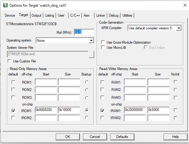

I'm working on stm32f103 and I found one problem which has a weird solution.
In my project, I have a bootloader and main source. I use the 0x800000 address to start the bootloader and 0x8008200 to begin my main project (the bootloader jumps to this address). after changing the main project:
address I defined also:
#define USER_VECT_TAB_ADDRESS in "system_stm32f1xx.c"
it opened me section where I wrote this
#if defined(USER_VECT_TAB_ADDRESS)
/*!< Uncomment the following line if you need to relocate your vector Table
in Sram else user remap will be done in Flash. */
/* #define VECT_TAB_SRAM */
#if defined(VECT_TAB_SRAM)
#define VECT_TAB_BASE_ADDRESS SRAM_BASE /*!< Vector Table base address field.
This value must be a multiple of 0x200. */
#define VECT_TAB_OFFSET 0x00000000U /*!< Vector Table base offset field.
#else
#define VECT_TAB_BASE_ADDRESS FLASH_BASE /*!< Vector Table base address field.
#define VECT_TAB_OFFSET 0x00008200 /*!< Vector Table base offset field.
#endif /* VECT_TAB_SRAM */
#endif /* USER_VECT_TAB_ADDRESS */after this everything works great if I will add __eneable_irq(); in the main source

Look at the bootloader you use. I guess it disables interrupts before jumping to the application. 0x8008200 is strange choice - it's in the middle of Flash page; why not 0x8008000?
Also, it's better to set the VECTBASE in the bootloader and remove any VECTBASE setting from the app. This way the only thing to change in the app while relocating the app is the Flash base address.
